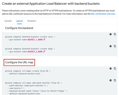

 Hi @AnbuKLB ,
Can you try creating a URL map & then a URL path matcher as described in
https://cloud.google.com/load-balancing/docs/https/ext-load-balancer-backend-buckets#create_an_with_... . Specifically, please see the examples in the gcloud tab of that page, as shown in this screenshot:
For the --backend-bucket-path-rules=PATH=BUCKET argument, replace PATH with /*, as shown in the following example:
--backend-bucket-path-rules=/*=mybucket
