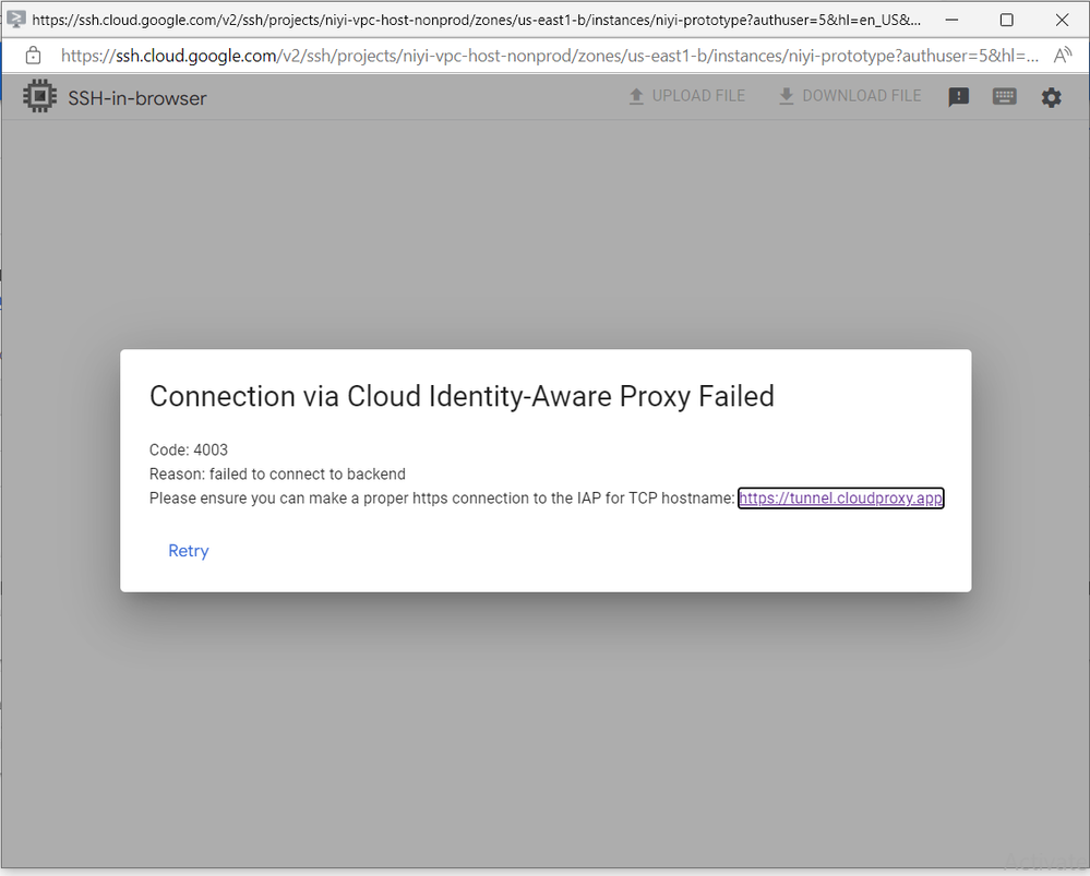

I can't ssh into my LAMP server
Firewall ingress rule allow port 22 from 35.235.240.0/20.
Firewall ingress rule allow port 443 from 0.0.0.0/0.
Firewall ingress rule allow port 80 from 10.1.0.0/16 (my vpc network). After seeing the console output, I opened port 80 to 0.0.0.0/0 but got the same result, could not login to ssh.ssh error.png
I have 2 vms in us-east1-b behind a cloud NAT. One is a lamp stack, and one is not.
I can't ssh in the lamp stack but I can ssh in the non-lamp stack.
Even when I add an external Ip to the lamp, I still can't ssh.
I have OsLogin and tunnel through Iap enabled project wide.
At first, after configuring the lamp, I could ssh w/o issue, but sometimes take long. However, since yesterday, I could no longer ssh.
I deleted the lamp but kept the disk and then create a new vm and attached the disk to the new vm and still have the same issue.
Attached is output of the console 1.
Kindly advise.

Thanks Usman, after some times it started working again. I think it was an issue with a ufw that i had installed on the VM. I tried disabling it and since then I have not had any issue SSh in the server.
