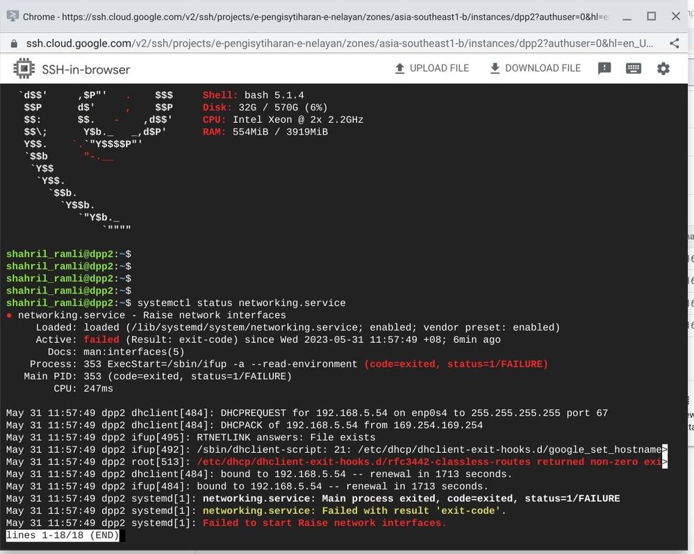

Hi Andrew
I have connect the instance using the serial console, but only for few hours only, after that it appear the metadata error. I also have screenshot new error regarding this. Have you encountered this issue?
HI,
As you see, the DHCP client can't get the right IP and as a result, your instance can't connect to the network. In GCE VM this function is configured by
google-guest-agent.service - I think you now install it on the migrated server or it not work properly. Here https://cloud.google.com/compute/docs/images/install-guest-environment you can find some instructions
