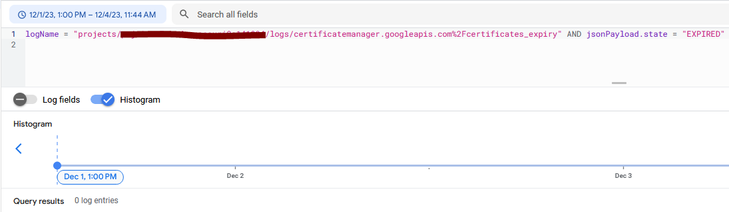

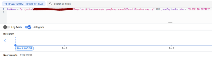

I follow this documentation and tried the suggested alert query "logName = "projects/PROJECT_ID/logs/certificatemanager.googleapis.com%2Fcertificates_expiry" AND jsonPayload.state = "EXPIRED"" in Cloud Logging. I also create 2 log-based metrics with that query for jsonPayload.state = "EXPIRED" and jsonPayload.state = "CLOSE_TO_EXPIRY". I replaced PROJECT_ID with the ID of my project.
I did a test with a certificate and let it expire but I can't see any logs relative to that (close to expire or expired), I only have logs for the creation of the certificate. I am surprised because as mentionned in the documentation : "Certificate Manager logging is always enabled and only captures a minimal amount of information specifically related to certificate expiration."
Here are my two certificates:
And the queries (without result) :

Hi @sosonetwork,
Can you try removing the syntax below from your query, just to verify if there are actually no logs?
AND jsonPayload.state = "CLOSE_TO_EXPIRY"
Since this is a configuration-based alert, it will only work if the Certificate Manager logs in Cloud Logging indicate that a certificate is close to expiration or has expired. You might want to create an issue in Google Cloud's public issue tracker regarding this matter.
Thank you.
