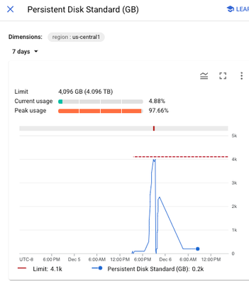

I'm experiencing a similar issue running Autopilot GKE cluster with a GPU workload/deployment with just 1 gpu/node.
The first time this happened, when billing info was added and I was able to get quota for 1 gpu, my "Persistent Disk Standard" consumed rapidly  started increasing towards 4TB when the cluster was trying to scale up to its first gpu node. I didn't find any place which listed where this space was getting consumed, and it went away after I deleted the cluster and recreated.
Now a little more than a week later, where things had been running fine with 1 gpu node, I see the "Persistent Disk SSD" increasing and reaching the 500GB quota, and the node/pod are no longer available and can't be provisioned due to exceeded quota. Again, I don't see any place where the space is getting used, and I'm not getting billed for this consumed persistent disk.
I'm hoping I don't have to recreate the cluster to address this issue when it occurs, since it would affect existing ingress to services.
