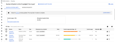

There is a soft quota for certain resources.
You need to navigate to the IAM > Quota & System Limits
 Look in my screen, notice the first and third lines.  There is a quota for the L4 GPU, that's used for Colab Enterprise.
You will have to go to GPUs (all regions) under the Name column.
Go all the way to the end of the line, click the triple dot and request additional GPU
 I suggest you request 1 at a time.  The approval usually takes a few minutes.  Hope this helps.
