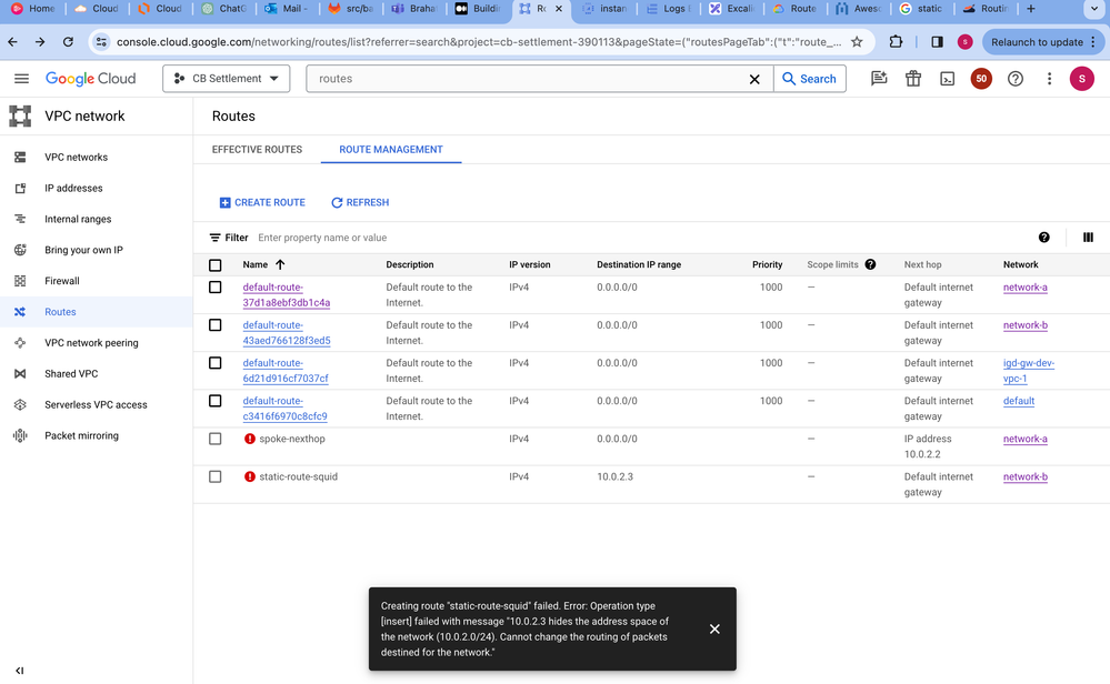

Hi Marvin
I have tried to add the routes as per your suggestion.I do not see a source option while creating a static route , i have added an instance tag as per below.I am getting an error which i am pasting below.Am I missing anything here?Screenshot 2024-03-08 at 10.30.42 am.png
Hi Marvin,
I was trying to add the route command and got the following error:
10.0.2.3 is the IP of machineB
machineA: sudo route add default gw 10.0.2.3
                     SIOCADDRT: Network is unreachable
