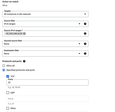

Hiya guys, I created a VM yesterday until tomorrow today at morning I tried to access the SSH login and got an error saying:
Connection via Cloud Identity-Aware Proxy failed
Code: 4003 Reason: failed to connect to backend Please ensure that: - your user account has iap.tunnelInstances.accessViaIAP permission - VM has a firewall rule that allows TCP ingress traffic from the IP range 35.235.240.0/20, port: 22 – you can make a proper https connection to the IAP for TCP hostname: tunnel cloudproxy app You may be able to connect without using the Cloud Identity-Aware Proxy.
I tried to follow this FAQ of firewall rules and added port 22 and RDP 3389. Still not working.

1. Check if your FW is configured properly = FW ingress rule should contain this IP 35.235.240.0/20 and port 22.
2. Check whether you have proper IAM permissions : IAP-secured Tunnel User assigned at your principal.
3. Check whether this API is enabled Cloud Identity-Aware Proxy API

Never mind, I found out that I didn't add UFW as port 22 so I've decided to use Serial Console and am able to add `sudo ufw 22` and then reload, now SSH is allowed to log in again.
I've marked this thread as solved. I just solved problem myself.
