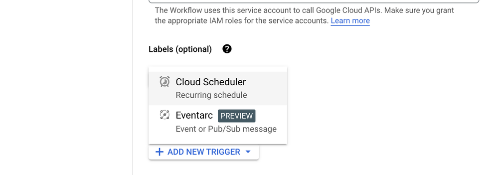

@Shamel  just for reference. I set the Cloud Scheduler job through the website UI when I am creating the Workflow itself. (pics attached) I see no indication on there how this Workflow will be invoked from Cloud Scheduler.

Once Cloud Scheduler triggers the Workflow successfully, this should be considered "success" by Cloud Scheduler and seems to be returned fairly quick based on my tests.
Scheduling a Cloud Workflow within Cloud Scheduler or directly in Workflows will have the same behavior from a scheduling standpoint. Although I'm not 100% sure, it seems as though specifying the HTTP method is abstracted away and may default to POST.
Thank you.
I did some tests and the behavior does seem to be consistent for both methods, creating a Cloud Scheduler job within the Workflow or creating the Cloud Scheduler job within Cloud Scheduler.
