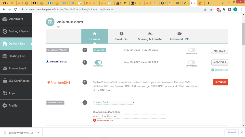

I purchased a domain from namecheap volunux.com and I named my bucket during creation as www.volunux.com after verifying the ownership in Search Console. I wasn't satisfied with the "Not secure" thingy, so I wanted HTTPS, I should have used Load balancer but I was looking for something cheap at the moment.
So I opted for Cloudflare to get me a free SSL and all was fine but here is the problem.

By the way, I just deleted the CNAME in the first row which is volunux.com and add another record with AAAA with volunux.com as the name and 100:: as the content, still it didn't work.
I contacted NameCheap, they mentioned something like DNS propagation issue and some people I asked to help me try the domain without www using naked domain and both http:// and https:// without www. said it work but it doesn't work with the naked domain on my own computer but works perfectly on my two tablet devices. I am confused.

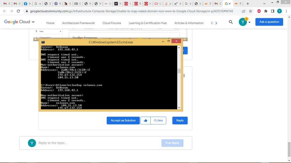

You will likely need the A record as well....AAAA is IPv6.  Add the A record, then on your client machine do a lookup from the command prompt with "nslookup volunux.com" and verify it comes back with the correct IP.
I just did as you said but I can't interpret what I got from CMD and which IP address to expect and which is correct.

Actually the nslookup wouldn't help as Cloudflare will be responding with their caching IPs in any case - so ignore me on that one.

I performed the ipconfig /flushdns, it didn't make any difference as it didn't work. Different site tools, crawler tools, PageSpeed Insight all tested the site fine with all http protocols with or without www and its fine. I asked relatives to help me try it, it works fine but for my computer, it never works if it is a naked domain.
