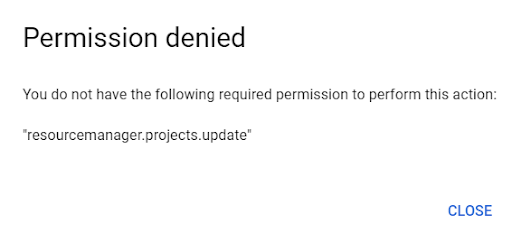

We have a use case to migrate 20+ standalone GCP projects (with no special resources like shared VPC  etc so very basic resources are present in the project ) to migrate to a new Org node. Interestingly 19 projects migrated without any error and 1 specific project failed with attached error although all  projects have same permissions and migrated by same user.The user who is doing the migration has owner permissions and also predefined  IAM project mover role. The permission "resourcemanager.projects.update"  that is shown in error below is part of the Project Mover predefined IAM role as mentioned in this link.

@JanR As i mentioned clearly these are standalone projects meaning they are not associated with any Org. And the resources inside them are pretty basic - GCE, Firebase and the like no edge case scenarios like shared VPC or others.  As for temporary glitch i have tried this operation atleast 10 times in the past 4 days but same result. There are also some GCP Console UI bugs that i noticed. Org seems to be greyed out in the "migrate projects" option and when i toggle between Orgs it comes back as active.  I have contacted Google Support and they are yet to come up with a solution. GCP has become like GWS starting to throw surprises 🙂 . GWS = Google Workspace
