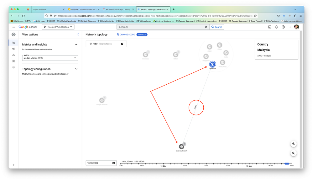

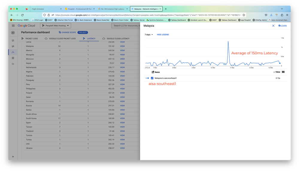

Thanks @Marvin_Lucero for the response.
When I check on the Network Inteligence > Performance Dashboard, the latency is about 150ms ~ 250ms... My VM instance is deployed in "asia-southeast1" region, which is the closest to my country "Malaysia"
When I check via Cloud ping test that you provided, asia-southeast1 is indeed the best region to deploy the server based on my country.
