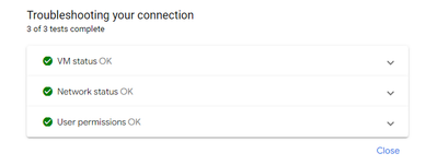

Thanks for your kind reply @Willbin I appreciate it. The compute engine can be stopped and started without problems. But when we try to connect with ssh (just like we always did with this instance before the datacenter outage, and we still do with other compute engine instances), we get the following error screen:

Our permissions are ok, port 22 is allowed on all our instances. When we do the Troubleshoot, all checks are ok:
