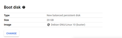

However, when I launch the instance via the template from the console, it totally ignores this setting and launches Debian image instead.  Did anyone encounter this problem?

Hi @BrunoA , ubuntu-dev is image family and before posting the question I verified that all the settings are correct and it's usable via gcloud cli.
I was probably unclear. There is a bug in Google console that rejects instance templates that use image families settings. As a result of this bug, it's impossible to launch instances via such template in Google console.
I would expect that most production teams would use image families settings instead of specific images since this simplifies production maintenance. Which means that for most teams, instance templates can not be used via google cloud console. Now, if I remember correctly, image families exist in GCP at least since  2017. It means this bug exists in Google cloud console at least for the last 4 years.
I am constantly working with AWS cloud and Google Cloud and I must say, I can not imagine that such basic bug for such basic feature would exists in AWS console for 4 years without AWS folks fixing it. So, please, @BrunoA  since you are Google employee and I am Google Cloud paying customer, please:

Hi Bruno, thank you for the reply.  I meant it does not work from UI console.
It does work with cli. So if I create an instance template via cli that uses image family (as opposed to a specific image) like this:
gcloud beta compute instance-templates create udev --machine-type=n1-standard-1
--network=... --network-tier=PREMIUM --no-restart-on-failure
--maintenance-policy=TERMINATE --image-family=ubuntu-dev
--boot-disk-size=20GB --boot-disk-type=pd-balanced --boot-disk-device-name=udev
and then will try to use it via UI console by launching a vm via instance template "udev", it won't use image family ubuntu-dev but will use Debian image instead.  I suspect it's because image family support has never been integrated into UI console.
