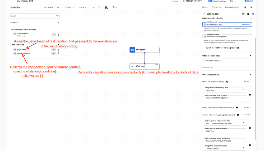

Hi Piyush
For fetching paginated API response, you can use While loop task and subintegration containing your connector task
Parent integration
Your parent integration will have an Api trigger and while loop task that will call the subintegration in multiple iterations as long as the connector output payload of last iteration is not empty
Create two local variables in your parent integration -
connectorOutput: (type)Json var, (initial value) { }
This variable is referred in the while task condition (see screenshot). Initial value is {} (so that the condition is non falsy) for the first iteration. This variable is then overriden in While Loop task to hold subintegration `Task_1_connectorOutputPayload`
When all the records are fetched Task_1_connectorOutputPayload and hence connectorOutput will be empty breaking the While loop
pageToken: (type)String var, (initial value) check empty string radio button
This variable is used to get paginated response as it stores the  subintegration variable `Task_1_listEntitiesNextPageToken` of last iteration and passes it to the next iteration
Sub integration
Sub integration will contain an Api trigger and connector task
Pls note the following points for the input and output of connector task
Task_1_listEntitiesPageSize : Provide any default value (ex 100)
Task_1_listEntitiesNextPageToken: Set it as input (to be overriden by parent integration) and output of the integration (to be collected by parent integration)
Task_1_listEntitiesSortByColumns: provide the primary key of the table here (or any other field)
Task_1_connectorOutputPayload: Set it as output of the integration (to be collected by parent integration)

Hi Piyush
Parent integration
Sub integration
