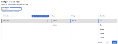

The connector is configured as follows:
Compare that to what I get with the linux command-line "ldapsearch":

@icrew , do you see another Entity called "OrganizationalPerson"?  If yes, can you try to do a LIST operation on that entity to see if it has these other columns you see in the LDAP search utility?

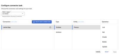

I only see "Person", no "OrganizationalPerson", unless maybe I'm looking in the wrong place? Here's a screenshot:
Thanks!
Ian
You can either drag in a new Connector Task or use the "RESET" button at the bottom of that screen, and then it will show you all the available entities again.  I suggest just dragging a new one in and wire it up as a parallel path in your integration so it runs both List operations at the same time and you can check the logs to see how each one is different.
