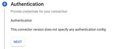

Second point concerning authentication. Once you have selected a service account, there is no authentication options to select.

As its service account based authentication, it does not require additional selection in Authentication section.

Yes, I just wanted to express that the documentation is somehow misleading in the Authentication section as the exposed parameters don't exist for the GCS connector (or I missed an option).
