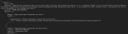

However, despite enabling the API, I am encountering the following error:

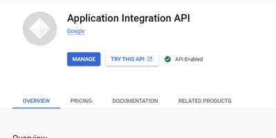

I have confirmed that the API is enabled. Attached is a screenshot for your reference.
I have attempted to access the API from the Cloud Shell, API Explorer, and Postman, yet encountered the same error across all platforms. Your assistance in resolving this issue would be greatly appreciated.

Hi @ahitankar
Aside from Application Integration API, you may check this guide for other APIs needed to be enabled on your project and proceed testing again.
I hope this information is helpful.
If you need further assistance, you can always file a ticket on our support team.
