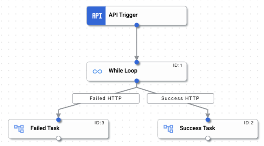

Main Integration
Here is how main integration would look like:
This integration uses two variables:
  1. retryCounter: Integer variable to keep track of attempt number
  2. responseCode: Integer variable which would have status code of last execution of rest caller task.
Other variables are optional.
This integration would work as follows:
  1. Integration uses a While Loop task to call the sub integration based on following condition:
$retryCounter$ < 5 AND $responseCode$ >= 400
  1. Once the condition for the While Loop is evaluated to false (due to max attempts reached or success response code), we can continue with the integration based on the latest responseCode value.
  2. Use any tasks instead of Success Task or Failed Task based on your desired logic.
