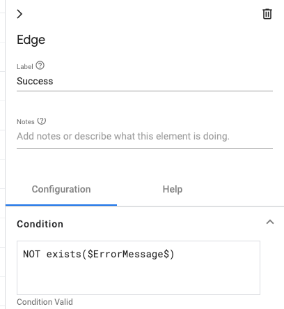

And, here are the edge conditions for the Error and Success edges:
Screenshot 2023-05-02 at 9.42.33 AM.pngScreenshot 2023-05-02 at 9.43.09 AM.png

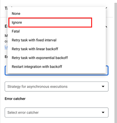

Yeah, It's possible to get the $ErrorMessage$ into a JSON variable. To do this you firstly need to set the `Error handling strategy` for ignore for your respect mode of execution i.e. `Sync` or `Async`. As shown below in the screenshot. And create a local variable with the `ErrorMessage` name as mentioned in the post.
