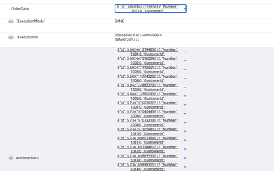

I want to load orders data from shopify to bigquery. Below is my application integration
1. Fetch Shopify Data is able to gather the orders data
2. Data Mapping: I am converting json into array.
3. For each loop calls the sub integration

Order Data from the parent integration service

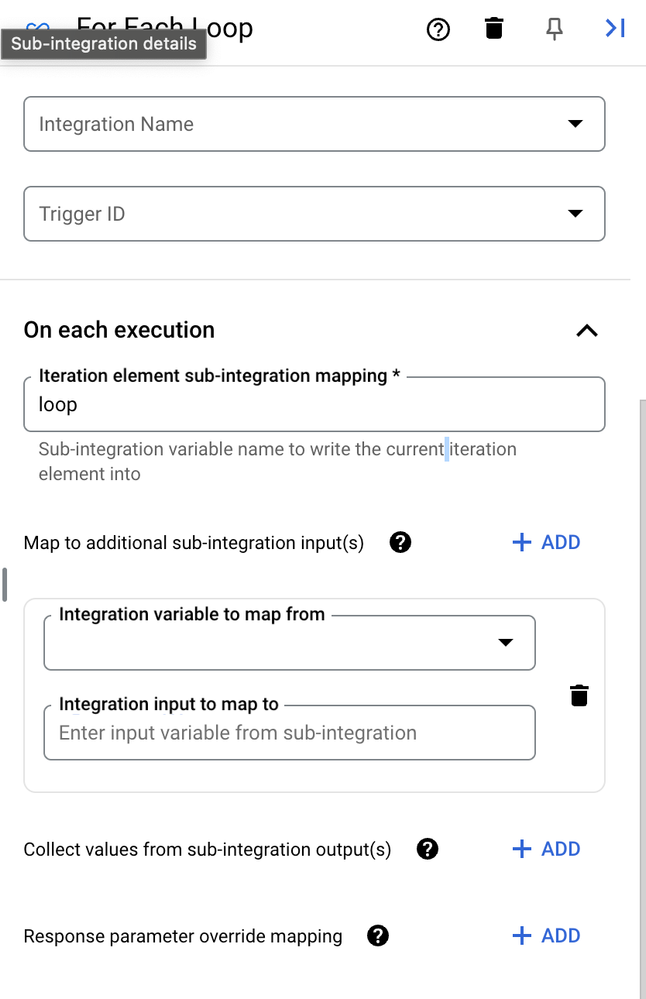

Thank you for asking this question. Have you mapped the variables("Map to additional sub-integration input") from the parent integration(the one which contains For-Loop) to the child integration(containing BQ connection) in your For-Each Loop task ?  Screenshot 2025-02-18 at 6.11.01 PM.png
Hello @vsy
Below is the setup, I have. Do you think I am missing something here. Please confirm
`Task_1_connectorInputPayload` - It is the input for subintegration
