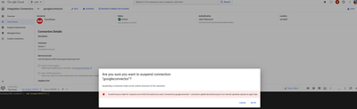

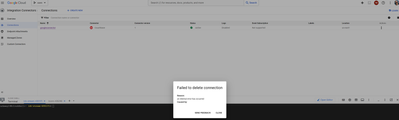

integration connections - cannot delete or suspend connection
After making a integration connection, the resource cannot be deleted or suspended.
Here are some screenshots and CLI outputs.
Has anybody seen something like this.
0 4 310

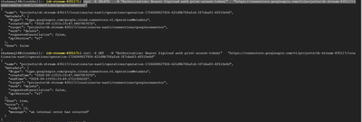

Hi @sunita-mv,
I did try that api:
curl -X DELETE -H "Authorization: Bearer $(gcloud auth print-access-token)" "https://connectors.googleapis.com/v1/projects/cb-stream-435117/locations/us-east1/connections/google..."
Unfortunately it still returned an internal server error.
