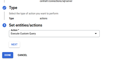

I used a sql server DB connector and I configured it to execute custom query to loop on a list of items and insert them in DB
the connectorOutputPayload variable which is the output of this step always returns [] even if the insertion in successful.
how can I detect the output of the DB insertion step in my Integration for error handling ?

When I configure the Connector task , with Action (execute custom query ) while using INSERT and UPDATE  sql statements  Both return [ ] in connectorOutputPayload variable even when they execute successfully.
sample statement.
INSERT INTO integration.dbo.[order] (OrderNumber, UserEmail, ItemName, Quantity, Price, VendorURL)
VALUES ('ORD67890','user@example.com', ?, ?, ?, '');
also the same issue happens if I configure Connector task , with Entities instead of actions and I choose (update, insert) they Both return [ ] in connectorOutputPayload variable, while the (select)
 @@ROWCOUNT can be a temp workaround I will give it a try but it will be nice to have any sort of indication if the execution in DB is successful or not in connectorOutputPayload object to detect how to complete the integration workflow and for better error handling.
when I tried this option with with Action (execute custom query ) on sql server connector there is a setback which is the custom query supports one operation at a time so I had to use 2 DB connectors one for the insert statement and another one to select the number of affected rows.
what If I want to execute a group of operations ,  If I want to read a group of sql statements from a file storage and then execute them on the DB.
which component/ task can I use ? or how can that be done ?
