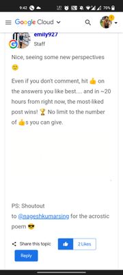

Don't worry @emily927 is tracking all things and identifying your fake ids

Won these ones before, I think u are doing this and trying to manipulate everyone. Stop doing this @akshat .

Yes u are right he is using fake id to like his own post by different names
This is not a game but @emily927 can easily verify who is using fake id 😂😂😂
