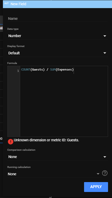

Hi, try this function in the custom field:
COUNT(Guests) / SUM(Expenses)
So, just for the scorecard aggregated, doing directly SUM(Expenses/Guests) should work, no?
No, you have to break it down like below:
