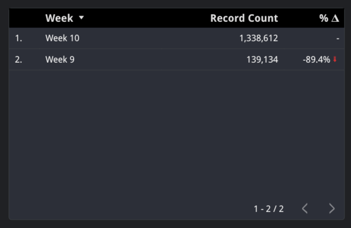

Although, when I changed the granularity of the table to Week, then the delta did properly appear:
hi, I had the same problem. I set the 'default date range' and 'comparison date range', but the delta was null. When I removed the date dimension from the dimension list of my table, the delta appeared.
