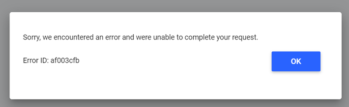

Sorry, we encountered an error and were unable to complete your request Error ID: af003cfb
I have the same issue. I am trying to connect to a SQL Server 2019 system, but the instance is 2017. It seems this may not be allowed. I am getting the "sorry we encountered an error" message but the error ID changes every time I try to connect. I would prefer to be able to connect using Windows authentication but that doesn't seem to be an option at all so I'm trying on a SQL Server authenticated database.
It's likely that the incompatibility between Looker's requirement for SQL Server 2019 and your existing 2017 instance is causing the connection issue. The changing error IDs might indicate underlying compatibility problems that Looker is struggling to handle
Please, verify that there are no network firewalls or restrictions preventing Looker from reaching your SQL Server instance.
Some extra configuration checks:
- Ensure the "SQL Server Browser" service is running on the SQL Server machine. This service helps Data Studio discover the SQL Server instance.
- Confirm that the TCP/IP protocol is enabled in SQL Server Configuration Manager.
- In SQL Server Management Studio, right-click on the server instance, go to "Properties" > "Connections", and ensure that "Allow remote connections to this server" is checked.
You also can try to check the connectivity by doing a Telnet f
rom a machine where Data Studio is running, try using telnet ServerIPAddress 1433 (replace with your actual IP and port). If successful, you should see a blank screen. If not, it indicates a network issue.
- Attempt to connect to the SQL Server using SQL Server Management Studio from the same machine where Data Studio is running. This helps isolate whether the issue is specific to Data Studio or a general connectivity problem.
