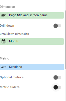

Hi everyone, I need to filter a graph to only show a certain page title, but when I try to do this via filters it only shows a blank graph. The quick filter works but obviously doesn't remain on the report when viewing it. The setup is below:

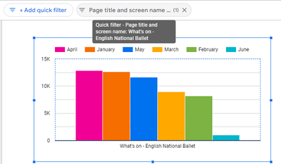

How I'd like it to look (shown with the quick filter on) is:
I'm completely new to Looker Studio but I've tried to configure filters to exclude every page except What's On - English National Ballet, but for some reason this only works when using the quick filter setting. If anyone has any advice I'd really appreciate it!

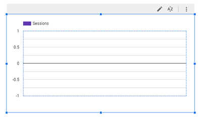

Thanks, unfortunately I've tried that filter configuration and it doesn't work. Below is the config I've tried:
We have several pages starting with What's On, so at least one should be showing up when the filter is applied but instead it just shows this:
The same result occurs when I use the advanced controls as well, as suggested.
Any ideas?
