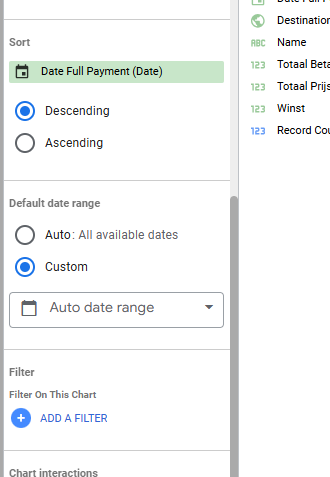

Your Default Date Range are set to Custom in your dataviz.
Change it to Auto, and they will change when you update the date range:2025-03-18 21_26_40-Boekhouding Jou Afrika Reis › Untitled Page et 19 pages de plus - Profil 1 – Mic.png
Hello, I added the example to the first page of your Looker report. Please check it. As Looker_Studio_B mentioned, you need to set the table date range to 'auto.' This will allow it to be controlled by the date controller.
One strange thing is that if you cannot change the report's date range, try creating a new table as I did. That should resolve the issue.
