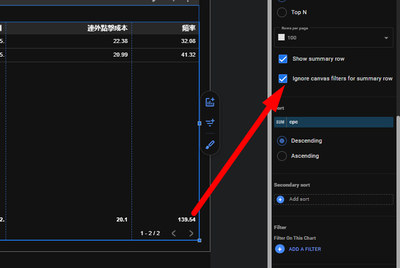

Hi, in your report settings, did you check this option? Please refer to the screenshot below. There can be different results depending on whether the box is checked or not, so I think this might be the main issue.
