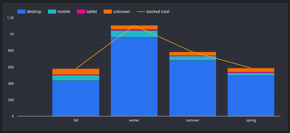

This should be possible! One way to get at this is to create a calculated field that sums V for all L. Then you can make this new field a line while the rest are stacked bars.
Thanks a lot.
