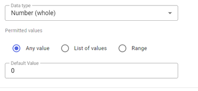

Hey @kevin-shen
It looks just fine for me when i setup a defaultt parameter value in the parameter section (and not in the chart I am using it).
When i switch it to 1.
Its being adjusted in thheh dashboard. I am using Input box field.
So perhaps instead of chhaning it in the properties section chhange itt in theh parameter set-up section.

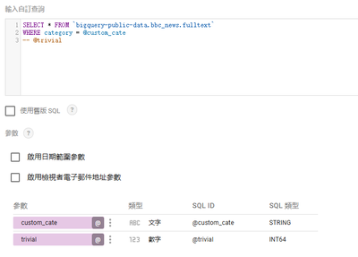

We discovered that the "Parameters" block becomes visible in the Properties view only when all parameters are included in the data source query. If any parameters are missing, the block will not appear.
To resolve the issue, we added the missing parameters to our query, and now the "Parameters" block shows up correctly in Looker Studio. We also found that including the parameters in comments within the data source query (e.g., --@parameter1) works as well.
All Parameters Included in Query
Missing Parameters in Query
