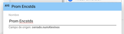

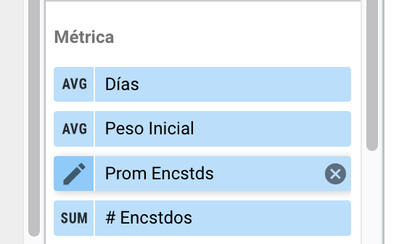

The way to access the original name is through the properties window, trying to edit the field. As you can see, the label you assigned appears in the name and below it the original name.
You can select the pencil...
Then you can see the original name here...
This works if you have renamed a field for an individual chart, but I'm afraid it does not work if you have renamed a field at report level.
