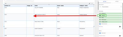

From my testing, it seems that the only way to display an image in a blended data table is by using an IMAGE field from the original data source (i.e., already treated as an IMAGE data type, not URL). This ties back to what @lauratilton  mentioned—IMAGE fields don’t seem to work well with CASE WHEN or other conditional statements. At this point, I feel out of options and would appreciate any suggestions or guidance.

Following up on this issue. I get the same problem in Looker Studio where the image doesn't render on table when I use blended data. If I use the original table source, it works.
