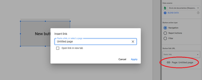

To edit the button's functionality, click on it and select 'Edit Link' from the menu that appears. An image like the one below should appear, where you can choose whether to open the link in a new tab or not.

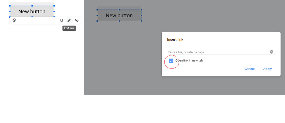

Sure, but have you followed the steps? If you check the button properties from the options menu (as shown in the image below), you might see the "Open in new tab" option unchecked, even if it is actually enabled. However, if you edit the link as I mentioned in my previous response, you will see the button’s real behavior.
Hope this helps!

This is the solution. Thank you very much!!!
