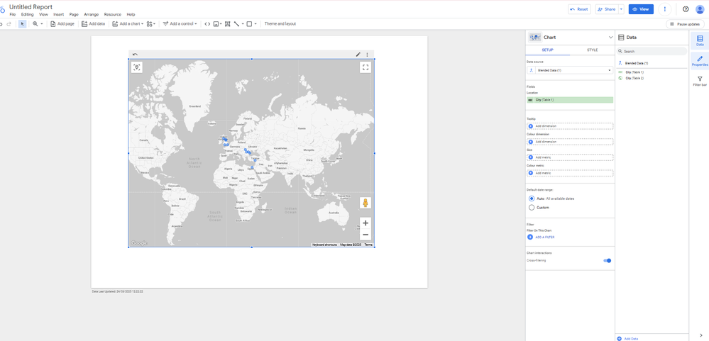

Desired ResultDesired ResultResult when I try to blendResult when I try to blend
On the first image you can see what I am trying to achieve, which I have done so by collecting all the data in un sheet, one tab. However, its becoming very dense and its making the report to crash, as per each different experience I need to add separate rows duplicating all the information. I have created a multiple selection for experience, but after doing 50 different individuals with experience, the map crashed saying there is an error with the configuration. So I had to restore my google sheet to an older version and it started working again.
I am trying now to divide it by region but when I upload the google sheet, it will only show me on the map the individuals located on the first tab "Europe" and not the other tab.
I am not sure how to fix this.
I would be very grateful if you an assist me.
According to your second graph, I believe you are using the blended data mode and have some incorrect settings. Could you provide some raw data (Google Sheets) for us? If you want to use blended data, the most important step is to check whether the data has been mixed correctly.
