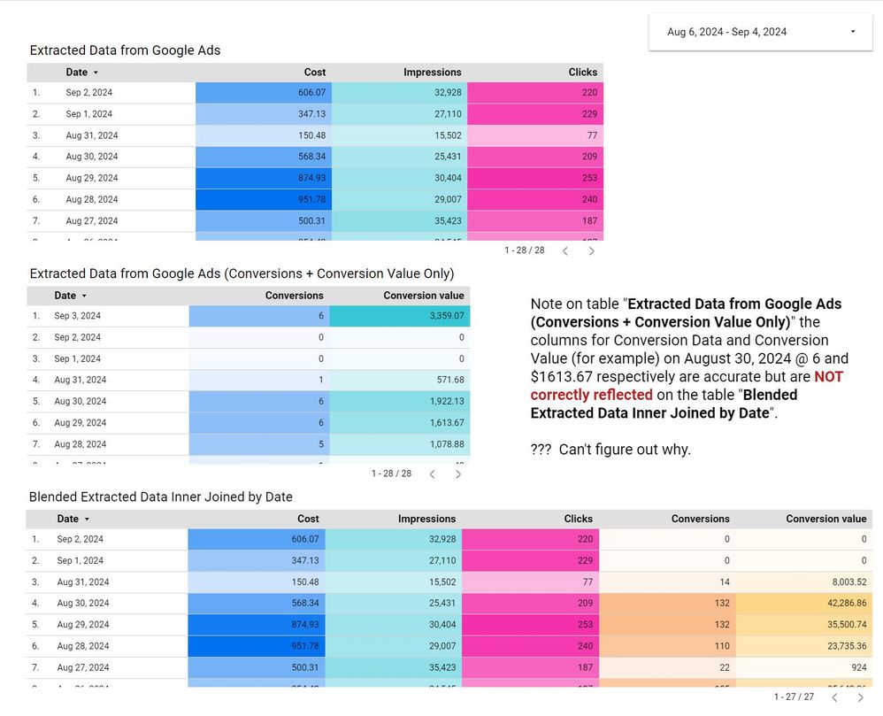

Note on table "Extracted Data from Google Ads (Conversions + Conversion Value Only)" the columns for Conversions and Conversion Value on August 30, 2024 @ 6 and $1,922.13 respectively are accurate but are NOT correctly reflected on the table "Blended Extracted Data Inner Joined by Date".  Same for other dates.
???  Can't figure out why.

I suspect a problem of blending configuration generating duplicated rows when a key is found. Can you make a screenshot of the blending configuration with the 2 blending tables and the join configuration from the popin please.
Usually, it is easy to solve without experimentation 😛
Mehdi
You're the man, Mehdi!
It is good to know there is a solution based on logic.
Here you are, Sir.
🙂 Thank you.
Found
- remove the conversion category if it is not on the other side (the main guilty part).
- switch the join type to left join (let's say that there are always daily impressions when there are daly conversions)
voila.

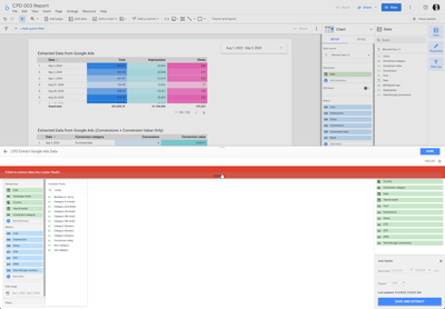

Ah.  Unfortunately we need the conversion category to filter on (later after we get the basic join working).  Because we want to report on (count and value) of particular conversion categories we were forced to create a separate data source to bring those in via join.  This is because as per Google API documentation only certain fields are usable with conversion category.  For example we can't bring in conversion category and clicks - weird i know.  we can and will try the left join however.  ps - dm me if you're fore hire with simple Q&A here and there.
ok, but just to finish with this problem, you cannot also add the conversion category in the right table and use it as a second join key with the date?
when we add conversion category to the [extract] data source google throws an error - likely because of the earlier reference to their api where they don't allow the combination of pulling conversion category with other standard metrics like clicks, costs, impressions, etc.  the source of this entire join work-around to begin with.
