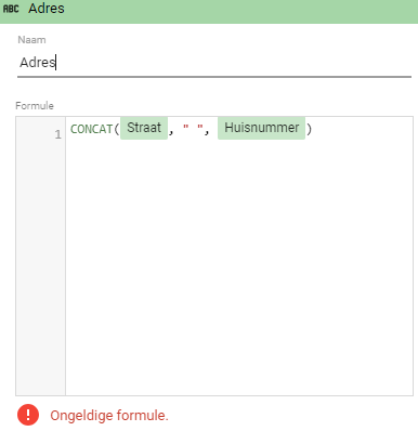

Out of nowhere formulas are supposed to be invalid.
I get errors in my formulas, that used to work. Looker Studio says they are invalid.

This was an existing formula. The formula does work, only the error shows up at formulas which are perfectly fine. Sometimes there are no errors, sometimes there are. This seems like a bug.

I have the same issue that appeared in existing formulas with the error message saying that the formula is invalid. I try to write the formula on a new one and the issue is directly present. I also tried to simplify the formula to return a simple numeric value and the same error continues.

I had the same issue and realized that some calculated fields where still appearing in the connection settings even though I deleted/modified them in the Data Pane.
I was able to solve this issue by going to the All Fields button when you are typing out the formula. Here you may see previous fields that you worked on that may cause the issue. I deleted these repeated fields by clicking on the three points and removing them.
After removing them I had no issue adding the same formula as before.
