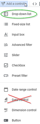

FYI to everyone experiencing this issue. I have a temporary workaround, but it is limited - you can only attach up to 50 accounts to the Google Ads data source.
The issue we are all having with our downloaded reports is being caused by the *default Google Ads data control.
If you create a new Google Ads data source (limited to 50 accounts) & then remove that default Google Ads data control from your Looker report, then add a drop-down list control (make it report level & use Account as the control field) then your downloads will work OK.
You can make additional copies to attach to addtl. accounts. I have 1 report that I've made 3 copies of to attach to a total of 131 accounts (so far). It's a pain to have all these copies, but the downloads work as expected.
*Screen shot of problematic default Google Ads data control:
Use a drop-down list, NOT the data control
Screenshot of replacement drop-down list control:
Hope that helps 🙂
