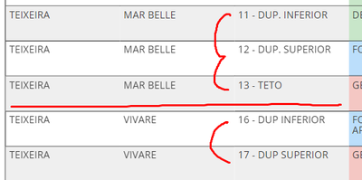

I want to sort my table in Looker Studio, with a third sorting, I already used the primary sorting and the secondary.
This is what I want to sort. I already sorted the first column, the second, but the third I tried to put numbers before the text to see if the Looker understand, but it interpret in different ways like this:
And then like this:
I personally would like to sort like the last image going crescent.
But I don't know how to do it.
