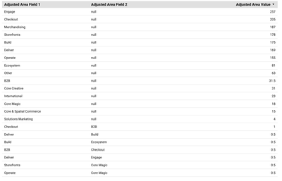

I want to combine the columns Adjusted Area Field 1 and Adjusted Area Field 2 into 1 column. I have created a calculated field so that hen the data has a non null value in Adjusted Area Field 1 and Adjusted Area Field 2, the value displays .5. When that happens, I want the count to count .5 for each area when the columns are combined. So for instance, with Deliver in Adjusted Area Field 1 and Build in Adjusted Area Field 2, I want to add .5 to the Deliver total AND .5 to the Build total when I combine everything.  How can I do this?
Just to be clear, are you looking to add 0.5 if either field is not null? So the results would look something like this?
Field 1 Field 2 Value
one null 0.5
null two 0.5
three four 1
If so, you could write a calculated field with some cases!
