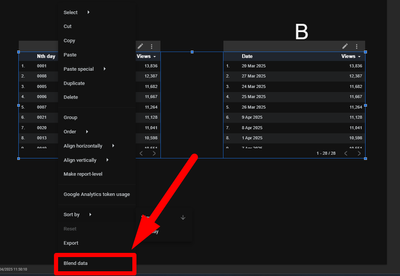

Hi @阿泰, thank you for the response
Here's the data that we have - the left data is from GA4 and the right is from Shopify. We've reduced the data in Shopify before just to check if any dimension or metric is causing the issue
Please let me know what you think
Thank you!
Most data blending problems usually come from "key matching" issues. I think your "Date" and "Day" fields might not be in the same format, which is why the data can't be combined.
Here’s one way to check if the data is correct:
  • Pull the two data sources into two separate tables—one for GA4 and one for Shopify. This will help you verify whether the date fields match correctly.
  • Use the auto data blending option to see if Looker Studio can automatically combine the data for you.
