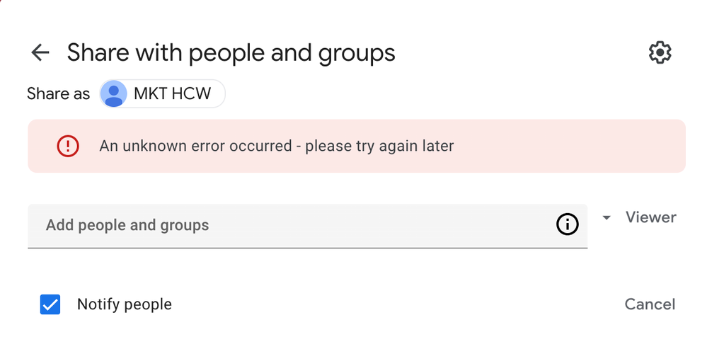

"An unknown error occurred – please try again later" when trying to share report with people
I cannot share looker studio report to others and got this error, could you let me know how to fix this? many thanks in advance. I confirm that email is correct but I cannot share and got error message

Thanks for your reply.  I see that with the same google account, I can invite others to my looker studio report on my Windows computer, but with my MacBook or Android tablet, I cannot share, it's so weird .... could you let me know?

I ran into this same issue. I couldn't edit the share settings of an existing report, nor invite new users. Just received the generic message
I inspected the network request when submitting the share window form and noticed the request was erroring with a specific message
{"reason":111,"errorStatus":{"reason":111,"code":3,"reasonStr":"RECAPTCHA_VERIFICATION_FAILED","errorCategoryStr":"LIMITS","category":4,"uniqueErrorCode":"3c55fb06"},"params":{"errorId":"3c55fb06"}}
 RECAPTCHA_VERIFICATION_FAILED - I'm assuming the form has an invisible recaptcha that isn't verifying correctly.
I'm using Firefox, after switching to Chrome I was able to modify the share settings again.
