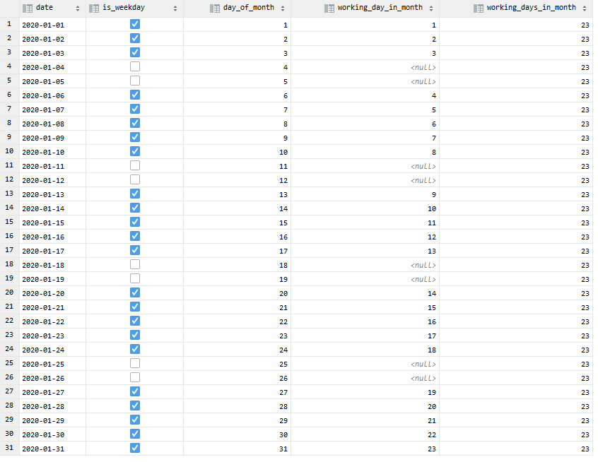

This is how I would do it in BigQuery:
WITH base AS (
SELECT
date,
DATE_DIFF(date, CURRENT_DATE(), DAY) AS day_offset,
COALESCE(NULLIF(EXTRACT(DAYOFWEEK FROM date) - 1, 0), 7) < 6 AS is_weekday,
EXTRACT(DAY FROM date) AS day_of_month,
DATE_TRUNC(date, MONTH) AS first_day_of_month,
FROM UNNEST(GENERATE_DATE_ARRAY('2020-01-01', '2020-01-31', INTERVAL 1 DAY)) AS date
SELECT
date,
is_weekday,
day_of_month,
IF(is_weekday,
COUNT(NULLIF(is_weekday, FALSE)) OVER(PARTITION BY first_day_of_month ORDER BY date ROWS BETWEEN UNBOUNDED PRECEDING AND CURRENT ROW),
NULL
) AS working_day_in_month,
COUNT(NULLIF(is_weekday, FALSE)) OVER(PARTITION BY first_day_of_month) AS working_days_in_month
FROM base
These queries would give me a nice table like the following:
NULLs for weekends are intentional. In order to take holidays into consideration, you would need to plug in a table with dates to your calendar and consider additional check like
IF(holidays.date IS NOT NULL, FALSE, is_weekday) AS is_weekday
