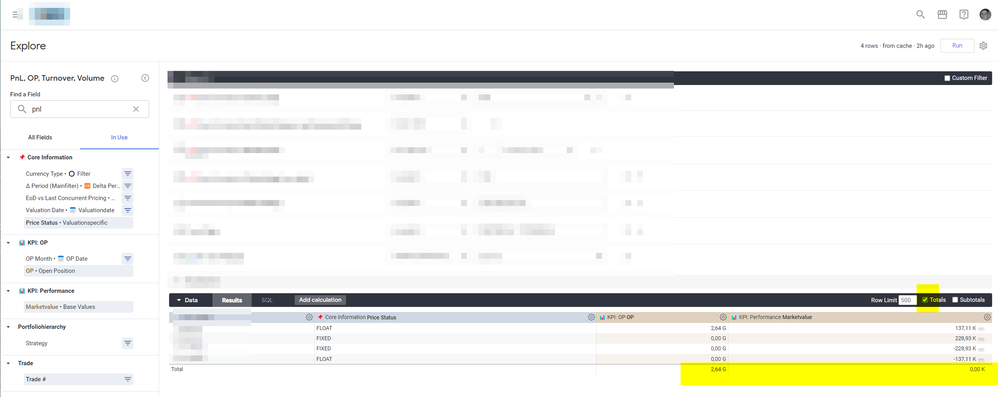

Complex issue with the way Looker calculates totals
Looker offers to calculate the total in addition to the details in an Explore:
This has always been a bit tricky, and in my opinion a suboptimal way to go.
Today, however, I encountered a problem that actually makes this path become ridiculous, and I don't know how to get around it either.

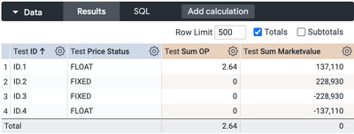

Here I now have the case where I only want to see the market value where the OP <> 0.
How does looker do that?
SELECT
SUM ( sum_op ) AS sum_op
, SUM ( marketvalue ) AS marketvalue
WHERE bla = bla
HAVING sum_op <> 0
Of course, this approach cannot work at all, because the sum over everything, i.e. without the elements (see screenshot 1) is not <> 0. Therefore, the total that looker calculates does not match the correct total.
The bad thing is: I don't see any model-technical way to get around this.
This is clearly a BUG for me as a customer, as the totals do not match the displayed values and my customer cannot trust the displayed totals.
With a dummy example like the one shown, the human being is still easily able to see the error.
But already with 10 lines, this is not noticeable and leads to wrong business decisions.

Here is the table unfiltered:
Here is the table filtered on OP > 0.
