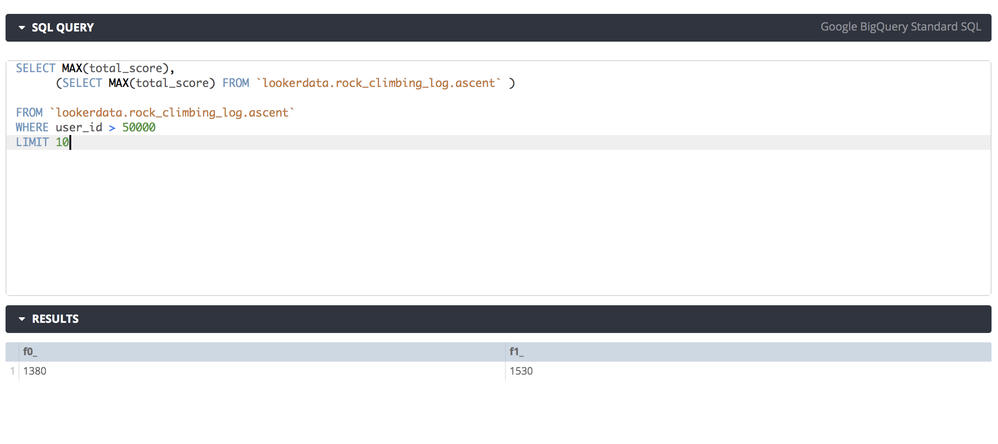

quick test to make sure that you could replicate easily:
f0_ is filtered according to the WHERE clause and is smaller than the result of f1_, the subquery, which is not affected by the user_id > 50000 filter.
