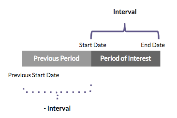

At a high level, we’ll be grabbing the start date and end dates of the time period as entered by the end user in the date filter. We use these to calculate the interval between the dates, subtract this interval from the start date (or you can think of it as the end date of the previous period), and obtain the previous start date. These dates then allow us to create a “timeframe” field for ‘period’ and ‘previous period’, which can be used to set up the single value comparison.

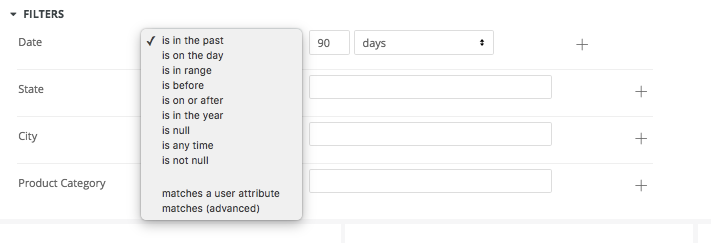

First, we create a date filter that we’ll add to a dashboard or look, which will enable an end user to enter a date or date range.
  filter: date_filter {
   description: "Use this date filter in combination with the timeframes dimension for dynamic date filtering"
    type: date
Next, we grab the start and end dates as entered by the user in the date filter. We use a syntax that was first described here.
https://discourse.looker.com/t/using-date-start-and-date-end-with-date-filters/2880
In order to account for the possibility that an end user selects “is before” in the date filter, we wrap this in a CASE statement that will make the start date ‘1970-01-01’ (unix epoch but you can make this the first date in your db, etc.). The same is done when we grab the end date of the filter, to account for the user selecting “is on or after” (where is the end date is the current date).

Once we have the start and end dates of the date filter, we calculate the difference between two dates to get the interval.
  dimension: interval {
    type: number
    sql: DATEDIFF(seconds, ${filter_start_date_raw}, ${filter_end_date_raw});;
# MySQL: TIMESTAMPDIFF(second, ${filter_end_date_raw}, ${filter_start_date_raw});;
Then, we subtract this interval from the start date to get the start date of the previous period.
  dimension: previous_start_date {
    type: date
    sql: DATEADD(seconds, -${interval}, ${filter_start_date_raw}) ;;
# MySQL: DATE_ADD(${filter_start_date_raw}, interval ${interval} second) ;;
Now that we have the previous period start date, the start date, and the end date, we can create a field with for the two timeframes we’re interested in – period and previous period. Whereas the “period” of interest is the time between the start and end date as entered by the user in the date filter, the previous period is the period between the previous start date and the “start date” (i.e. the “previous period” ends when the “period" begins). Here you’ll use a date field (like ${created_on_raw}) that exists within your model already.

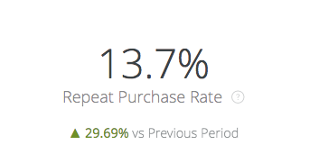

You can now create the look that you need using the timeframes field:
Make sure that if you have another date filter on the dashboard, the looks that are to be dynamically filtered are responding to the “date filter” above.
