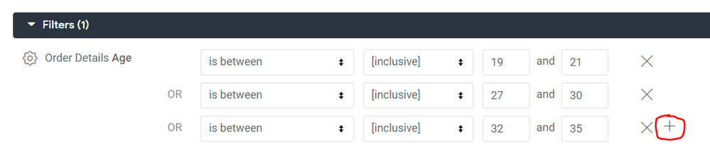

Are users going to be doing this from an Explore? If so, it should be possible to achieve this through the Explore filters. Clicking on the + button on the right-hand-side of a filter adds an additional line on that filter with OR logic, e.g..
Does this achieve what you need?
