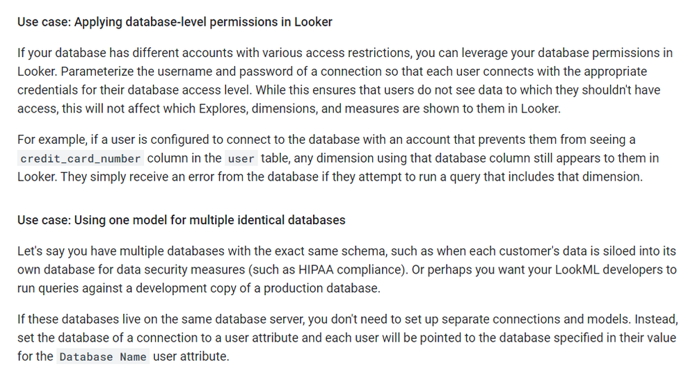

But in this Google document: https://cloud.google.com/looker/docs/admin-panel-users-user-attributes  they have mentioned that we should be able to use user attributes to dynamically change the database connection inside a model. I have attached a screenshot for the same:use_cases.png

Yes, user attributes can be used to dynamically change the connection based on the user. However, it cannot be used in the "connection" parameter as you've attempted. Using liquid can only be used in LookML in the places noted in this link. To accomplish what you're looking to do, you will need to add the user attribute in the database connection (i.e. Admin menu --> Connections).

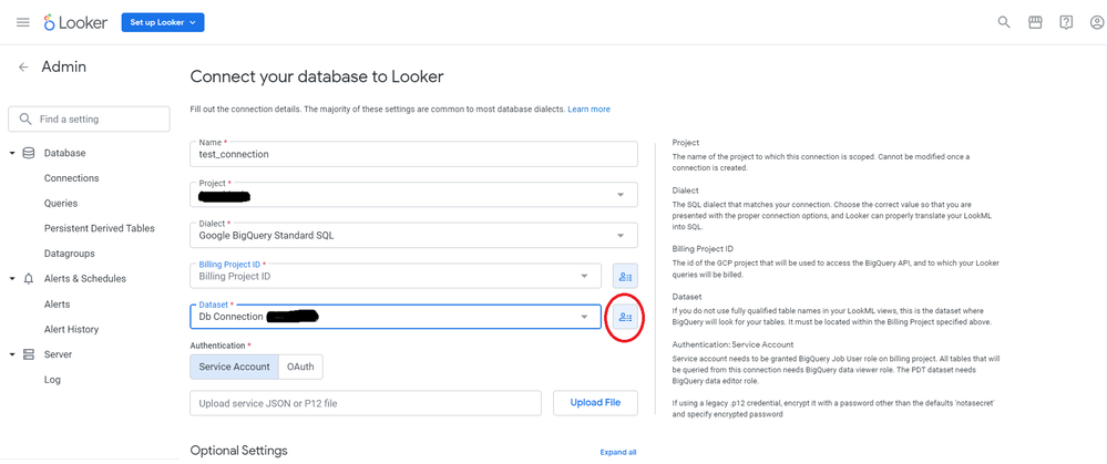

Hi thanks for your input! I tried what you suggested today but I'm still a bit confused about the entire process of it. So, I went to admin connections as you mentioned:
 As I mentioned earlier I created a user attribute named db_connection and under the "user values" tab I have assigned myself the "siem_1" db_connection value and another member of the team "siem_2". This user attribute ( "Db Connection") which you can see is one of the options available when I clicked the button available on the right side of "Dataset" field. In the brackets I am able to see the string or db name ("siem_1") that I assigned to myself. But shouldn't I directly choose the db name here? or the user attribute will work just fine? or should I choose some field other than "Dataset" to assign the user attribute to? Just wanted to know if I am going in the right direction. Also if you could explain the process about how it would work in real time or provide a documentation for the same, it would help a lot. Thank you!

What you're doing is correct. You should be able to test this by running a report as yourself from an Explore built on the model that uses this connection. Then you can sudo as the other (i.e. the one with the "siem_2" database user attribute value) and running the same report. you should be able to look at the SQL in the queries and verify the FROM clause is sourcing from the different databases.
