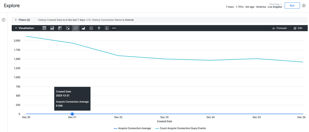

The first thing we can check is if the amount of requests for a specific connection is hitting the threshold for number of active connections, we can use the following URL as a base:
  • https://<instance_domain>/explore/system__activity/query_metrics?fields=history.created_date,query_metrics.acquire_connection_average,query_metrics.count_acquire_connection&fill_fields=history.created_date&f[history.created_date]=7+days&f[history.connection_name]=<connection_name>&sorts=history.created_date+desc&limit=500&column_limit=50&toggle=dat,pik,vis
Which will show a graph similar to this:
As we see on the graph, we have a big count of Acquire Connection Query Events, which means that for that connection we are surpassing the limit on simultaneous queries we can run at a time very frequently, this means that for some users, their queries may appear slower as their queries have to wait for other queries to complete before they can be executed.
The Acquire Connection Average value can give us an estimate on how much time the queries have to wait (queued) before a connection is available for their execution, in this case, the value is less than a second, so, depending on the use case, it may be a value we can work with, however, if we want to remove any additional runtime related to this we will have to change/test with the settings on the Looker application, including the specific connection and the source database limit configuration.

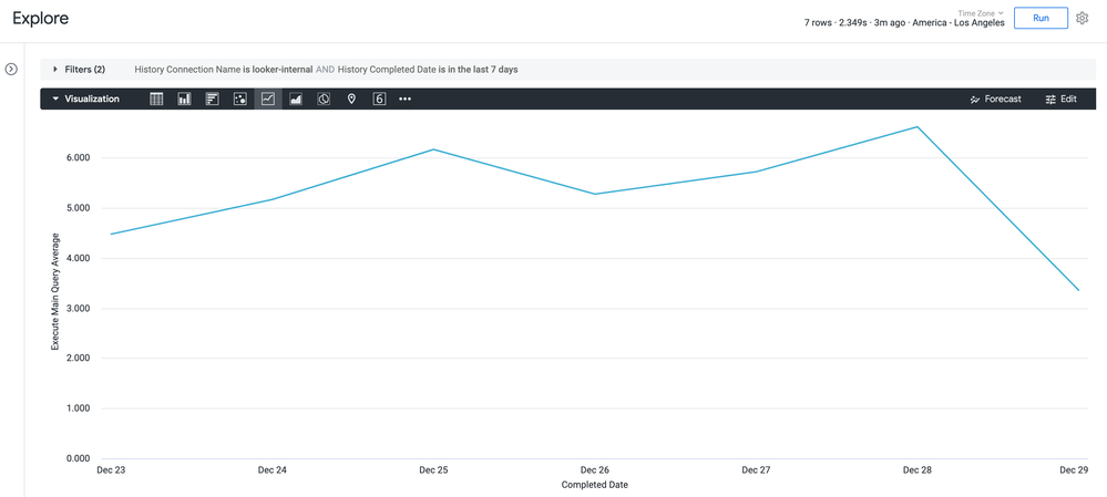

Finally, there could be some changes on the actual execution runtime of the queries once they reach the source database, Looker keeps track of that timing as well, we can use the following URL to see if there are any relevant spikes for it:
  • https://<instance_domain>/explore/system__activity/query_metrics?fields=history.completed_date,query_metrics.execute_main_query_average&fill_fields=history.completed_date&f[history.connection_name]=<connection_name>&f[history.completed_date]=7+days&sorts=history.completed_date+desc&limit=500&column_limit=50&toggle=dat,pik,vis
Something like this may be shown:
If sudden spikes are seen in this graph, it may indicate that your database is having problems either with the amount of requests or the complexity of the queries that are being sent from Looker, it is recommended that we review the resource metrics on the database to see if there is a problem in that aspect (and that you must rectify), networking issues can also impact the runtime (not very common, but it can happen if something is changed on the database side) so you could also review that just in case.
Of course not all SQL execution runtime problems are related solely on the database, there could be some taxing content (DashboardLook, etc.) with complex queries that may be impacting the performance on the instance (for which the modeling may have to be reviewed/refactored on your side), or a change in the application/LookML that is now adding more complexity (LiquidTotals/Subtotals, PDTs, etc.) to the generated SQL queries, to mention a few possibilities, in such cases it is still recommended to gather as much information as possible on database resources and recent changes on your content/code before reaching out to the Looker Support team, to help expedite resolution.
